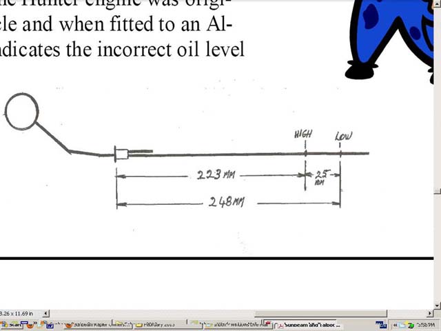

We had a tech tip in our newsletter on this.
If the engine comes from a Hunter you do need to modify the dip stick, because the motor in the Hunter is leaned over.
No modification is needed in a Rapier Fastback.
The measurements are:
22.3mm and 24.8mm.
1962 Series II Alpine
1957 Series I Rapier

286 Posts
Posted - 17 Jun 2013 :  13:21:44  Show Profile  Reply with Quote
Thanks sunalp2, have not got around to it yet, I will check it out and mod mine .
