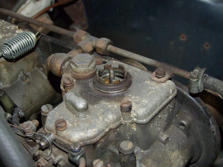

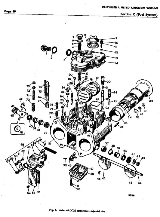

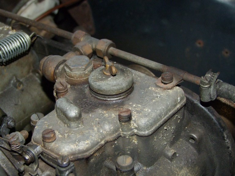

1922 - Can I ask you to please take some pics of exactly how the domes and spacers are supposed to be fitted on the webers ( as they came off after removal )I think I have mine mixed up somehow. |
549 Posts |
Posted - 22 May 2013 : 20:39:36
No problem:
This is the spacer only:
Spacer and cover:
Last the diagram from the workshop manual:
286 Posts |
Posted - 23 May 2013 : 08:03:20
Thanks a stack . Jan |
