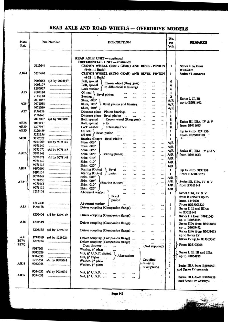

I've got a parts book for Series VI Rapier (closest I can get to a Gazelle VI) and compared the part numbers in '72 Hunter Range parts book.
The part number of 4.22 crown wheel and pinion for a Series VI Rapier is listed as 5220640 same as the fastback Rapier (there is no 3.89 listed for the Series Rapier).
The differential box (the bit the crown wheel bolts to) also has the same number, as does the front bearing.
The drive flange is a different number.
No numbers listed for the casing.
I would say that you can certainly use the internals of that unit and maybe the whole differential assembly.
Worth a try if you can get it cheap.

Posted - 18 Jan 2013 :  12:18:58  Show Profile  Visit 1922's Homepage  Reply with Quote
Hmmm - The Parts Book is "SUNBEAM RAPIER SERIES I-V" but the page (see plate ref AB24 near the top) clearly lists "VI".
Perhaps it should be "IV"?
There's no such thing as a series VI - doh.
Edited by - 1922 on 18 Jan 2013 12:21:26

I was looking at the workshop manual over the weekend and the diff is listed as different on the H120 compared to the std rapier 3.89 v 4.22, unless I am reading it wrong??
Edited by - JPSH120 on 25 Feb 2013 11:18:43
Posted - 26 Feb 2013 :  13:17:10  Show Profile  Visit 1922's Homepage  Reply with Quote
Nooo - you are reading the manual correctly. The standard manual gearbox Rapier was always built with a 4.22 diff. It isn't one of the cars they fitted the 3.89 to.
