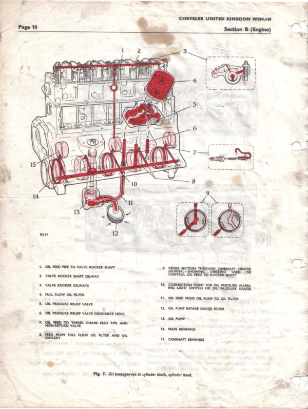

Thomas. Wheres the pressure release valve?
549 Posts
Posted - 11 Nov 2012 :  20:31:28  Show Profile  Visit 1922's Homepage  Reply with Quote
Oil pressure relief valve is in the aluminium block that the oil filter screws onto.
It's the large bolt just below the filter, the complete valve can be removed and cleaned.
