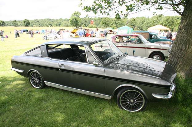

My project car is fitted with 7 x 13 Wolfrace slot mags, so I cast a ruler over them to work out the offset. The calculation for the wheels is...... (177.8 / 2) - 101.6 which gives 88.9 - 101.6 = -12.7mm offset.
The rims measure 3" from the hub face to the outer flange, and 4" from the hub face to the inner flange. This is how they look on the car.
They are fairly deep dished but TBH I'm not sure you could get much deeper without risking interference under standard arches. On american wheels they refer to the hub face to the outer wheel flange as the 'backset' and I would say that looking at mine that 3" is probably the safe limit if you want to keep the arches standard. I think Turbinecol is right, so check them carefully before you decide.

Hi Tom.... I was lucky in that I already had these wheels when I bought the car so could actually try them without worrying whether they fitted or not. Really is like turbine col was saying before about offset in that.... it's not so much how wide the wheels themselves are, it's where the hub flange is in relation to the width that is the crucial bit.
The Americans use 'backset' as a way to measure the outer rim clearance but it does not take into account caliper clearances on the inner rim, but with a 15" wheel is very unlikely you will have a problem there. So the best way to be sure that your wheel won't interfere with your arches is to measure the distance off the hub face to the outer edge of the rim. I've found that 76mm is really on the limit with only a 2mm clearance to the tyre wall. (Rear Arch)
I've lowered the front of my car substantially so it might not be relevant to yours, but as you can see in the pic, the front wheel (which is same dimensions as the rear wheel), is tucked further under the wing. Yours will have a slightly wider radius (maybe 50mm including tyre) but will be under a car that is 90mm higher. (My car has a 20mm lower profile than standard tyre on the front).

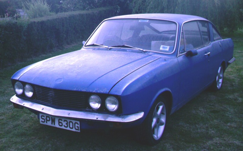

I've got 7x15 rims on mine - I think the offset is 30mm.
Using 195x50x15 tyres.
Edited by - 1922 on 23 Nov 2012 20:29:12
Posted - 23 Nov 2012 :  20:31:55  Show Profile  Reply with Quote
Too bad Tom.... Derek's beat you to it. Looks the dog's dangly's as well! Are they aftermarket or is there a Ford running around on it's hubs somewhere Derek?

Comparing Derek's pic with mine you can see the difference quite clearly in that the large dish that mine have, has the effect of pushing the outer rim further away from the hub and nearer to the arch even though both sets of wheels are 7" wide.

549 Posts
Posted - 23 Nov 2012 :  20:54:18  Show Profile  Visit 1922's Homepage  Reply with Quote
They are TSW Stealth, put them on this one (when it was still Argonaut's car) and my previous Rapier years ago (10 I'd guess).
I had some Ford RS style Compomotive 7x14 rims before this.
Like this:
I was told at the time they were a very common offset typically used on Fords.
The offset is stamped on the back - but my spares are tucked away in mum's spare room ten miles away at the moment so I cannot look easily.
I use a 3mm spacer on the front to stop the tyres rubbing on the suspension tower and anti-roll bar (they still do a little on full lock).
The car is also lowered 25mm all round.
The rear tyres are close to the wheel arch but never actually touch.
Edited by - 1922 on 23 Nov 2012 21:06:02

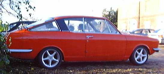

549 Posts
Posted - 23 Nov 2012 :  20:58:27  Show Profile  Visit 1922's Homepage  Reply with Quote
Here's a pic of my old Rapier (now Jon's) in the company car park - back in 1998.
Edited by - 1922 on 23 Nov 2012 21:08:30
