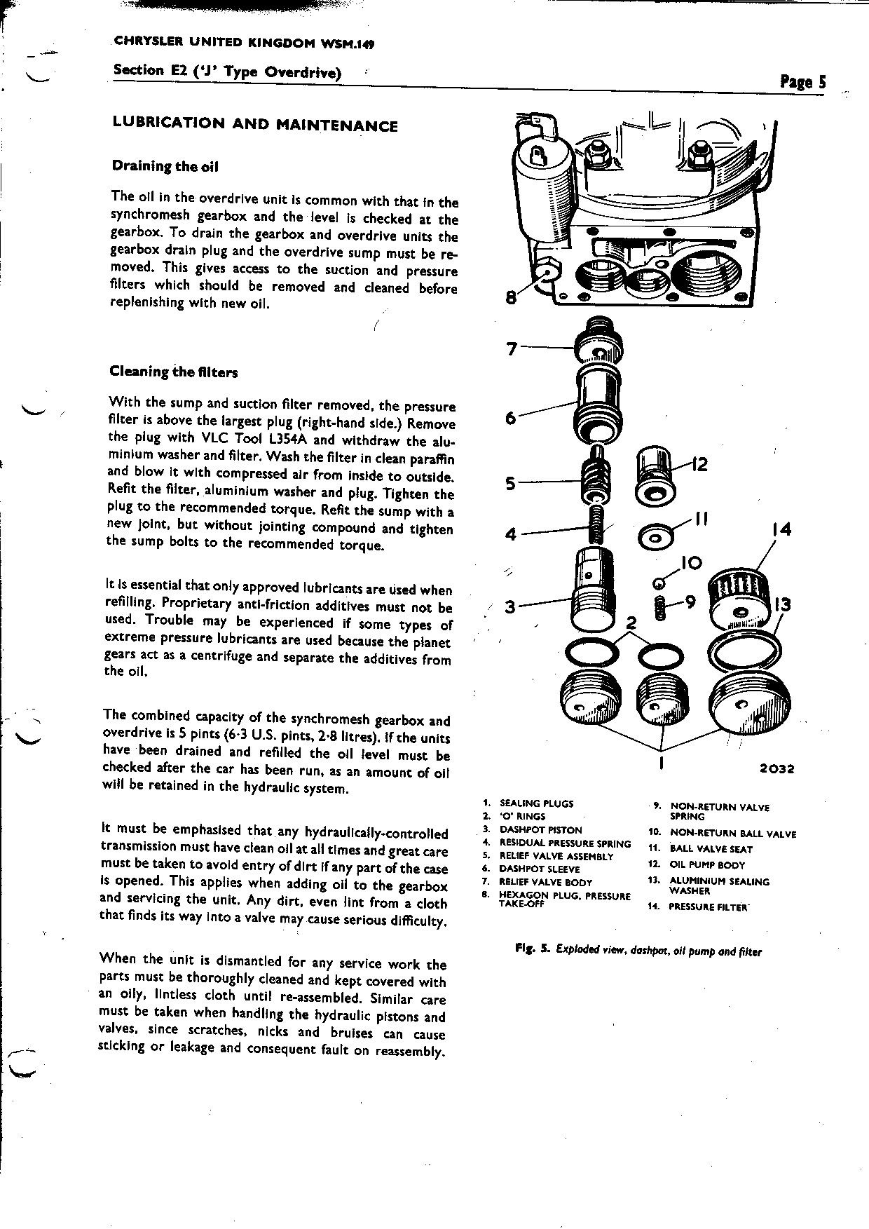

If it is J type you have to remove the sump and, ideally the filters and give them a good clean. Unfortunately you will need a special tool to remove the filters - though you might be able to make one.

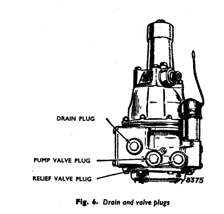

If it's the earlier D type it looks like this:
Posted - 05 May 2012 :  09:22:21  Show Profile  Reply with Quote
'D' to the rescue - cheers for all that info. I forgot to look at the box I have in the garage anyway!
