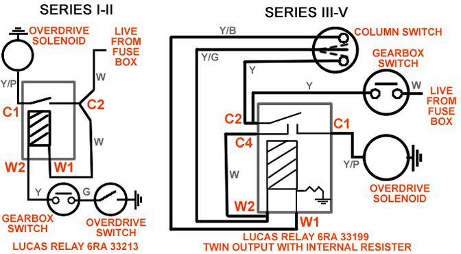

Hi all, Does anyone know where I can get a wiring diagram please, for the overdrive loom which will cover my Rapier series V? I have a manual which has several diagrams but none show the overdrive circuit.
Cheers Tone.

Hi Tone,
Look into WSM 145 in section E (Gearbox & Overdrive) on page 5 Figure 4B and there you find the wiring regarding the self cancelling switch.
Regards,
Peter

Posted - 26 Feb 2020 :  17:17:36  Show Profile  Reply with Quote
Hi here is the diagram I think you need. The alpine serie 3 to 5. make sure you have the correct switch and relay.
I did it one my serie 3a and it works fine.
best regards

Peter,
WSM 145 ?
pruyter
Netherlands
325 Posts
Posted - 28 Feb 2020 :  14:32:25  Show Profile  Reply with Quote
WSM 145 is the workshop manual for the so called Light car range from Rootes which are the Audax cars with 1725 cc engine.
If you don't have this WSM, but you have WSM 124 (Rapier and Alpine) you will find the same diagram in Section E(Gearbox &Overdrive)on page 18 in figure 13A
