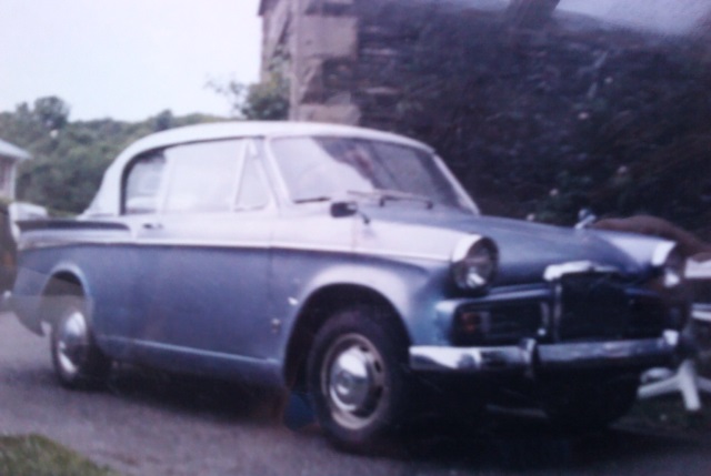

  Can you post us a picture of yours ??

  This image is from a few years ago before the front wings had to be replaced due to rust. I will upload a more recent image the next time I get it out the garage.
