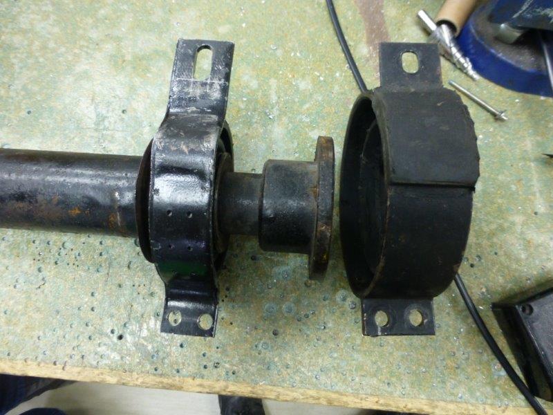

Posted - 09 Jul 2018 :  18:31:45  Show Profile  Reply with Quote
Finally beat the new prop support into approx. the right shape and assembled on to the prop.
I thought you may like some pictures.
I noticed the new bearing is slightly eccentric in its mounting.
I don't think it'll matter.
The 'home bent' brackets probably don't help either.
I turned up some 5mm spacers to fill the space left by the new bearing.

Posted - 26 Jan 2019 :  18:48:34  Show Profile  Reply with Quote
Hi Mike..... only just picked this up from the link to the thread you reposted. I too was a little concerned because I couldnt centre the bearing any better than you did. The bar is really tough stuff to bend into shape.
Test drove it shortly after I completed the job and took it up to around 60 mph with no apparent humming or vibration. Have you test driven yours yet?
